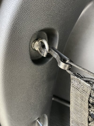

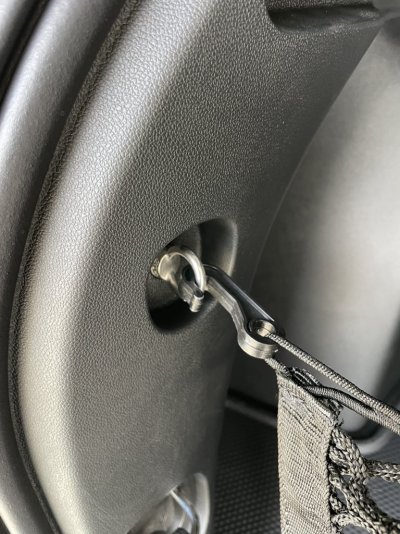

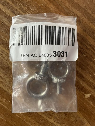

See below for the solution I came up with. Use a small screw driver and pop the plastic cover off where the bolt go. The threads are M6. I found the following lifting bolts work well from Amazon.

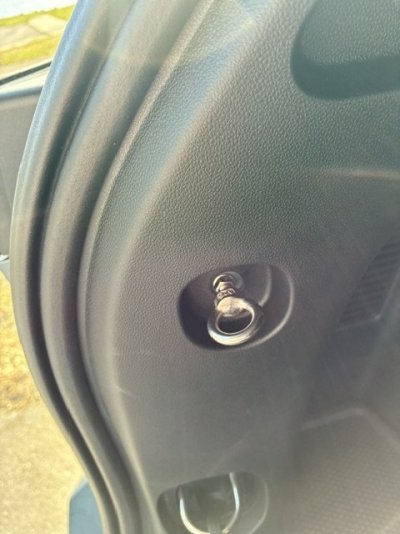

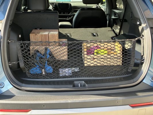

I purchased the Chevy Cargo Net, https://accessories.chevrolet.com/p...QPNBtfq/MVhqUp0gMPUURbIaGHbth65bM=&bac=114654, as I had enough GM Rewards points to pay for it. It comes with the appropriate mounting hardware. As others have mentioned, just take a screwdriver to pop off the covers in the upper "nook" above the built-in rings. You will then see a threaded hole where you screw in the hooks that came in the package. I had mine delivered to the parts department at our dealer (No shipping costs that way). I removed the covers and installed the net in less than 5 minutes in the parking lot before heading off to buy groceries. Works like a charm and I like the built-in storage bag for times when I remove it.
