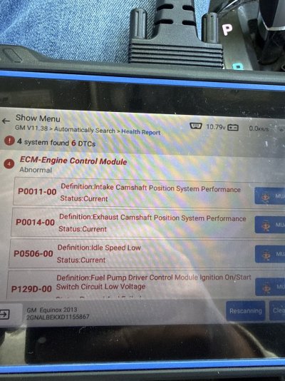

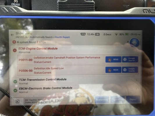

Two months later the daughter was getting gas. It died. Embarrasing to share, the boyfriend called and said I think its out of oil. So I told him to grab a few quarts of 5w30 and fill it up. Started it back up and she took it to college. It about an hour and half drive away from home. No issues. I think it did die one other time at idle. She gets home and last Saturday I decided to look at it. I started it up and it ran fine for a minute or two. I turned it off. Since I went cheap and bought an Amazon timing kit and the vvt solenoids I decided to replace those. I bought two oem vvt solenoids and swapped them out. It started and ran well about 30 seconds and then started dropping 800 rpms and then back up and down before finally dying. I had bought a mucar 632 reader. Its pretty awesome actually. Had an intake camshaft position code P0011. My cousin said its not timing. It really can't be. He said its your VVT Sensors. So I swapped them back out with the cheapos just for kicks. Same results with different parts. He suggested a compression check to verify I should even continue throwing parts at it and spending the time I was on it. So I did. All cylinders showed over 175 psi. He said to continue on then. lol

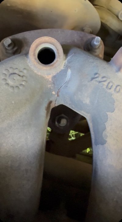

I decided I would go to google AI. I gave them all the information and listed all the parts l replaced and it told me to look at my fuel trims. I gave the results and it said to look at my exhaust manifold. There was my issue. Staring me in the face after I removed the heat shield. Replaced it and boom. Fuel trims were perfect. Then it died. Here we go. I had doubts that crack that was in the exhaust was killing the engine. I knew it wasn't helping things but something told me it wouldn't fix my issues. So I went back and told Google it was still dying. They said "you need to clean your pcv orifice. Obvious PCV issues going on here." I asked if I just cleaned that a few months back and it is actually clean, is there anything else. They aked if there was suction or blowing pressure when removing oil cap. I have pressure and not suction. Google AI says I "obviously have a ruptured valve cover and it needs replaced. With the exhaust manifold fixed and no vacuum leaks anywhere else it has to be coming in through the manifold, or rings." Ugh.
