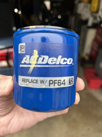

I did my first oil change at 537 miles. Here is the filter that was on it. I replaced the filter with a Purolator BOSS PBL11403.

That Purolator certainly is listed as an equivalent to the UPF64R. Looking at the PF64 you removed, it's gone through an artwork change from those that preceeded it. I wonder if GM just quietly upgraded the 64 to at or near UPF standard. Thanks for showing the original. Here's a picture of what PF64 has looked like for the past decade or 2.PF64.jpg

That Purolator certainly is listed as an equivalent to the UPF64R. Looking at the PF64 you removed, it's gone through an artwork change from those that preceeded it. I wonder if GM just quietly upgraded the 64 to at or near UPF standard. Thanks for showing the original. Here's a picture of what PF64 has looked like for the past decade or 2.View attachment 2222
That filter was installed by the factory.

Yes, the departue from the artwork over the past couple of decades in favor of the latest style leads me to believe that the canister that came from the factory as well as subsequent new cans may have been upgraded. Out of curiosity, I may try and get one of the newer looking cans and compare it to an older PF64. If I do, I'll post it to this same thread.
