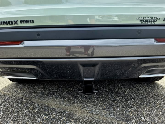

I checked my 2018.
From the bottom of the bumper cover to the garage floor is 12 inches.
The bottom of the factory installed hitch is 14.75 inches to the floor.
The factory receiver is 3 inches top to bottom.
If a trailer hitch was installed and the top of the receiver touches the bottom of the bumper cover, the bottom of the receiver would be 9 inches from the floor.
@Enjin what is the distance from the bottom of your 2025 bumper cover to the floor?
Penright, what is the distance from the bottom of your bumper cover to the floor?
2025 LT/Activ - 13.5 inches from bottom of rear facia to ground. 9.5 inches from bottom of receiver to ground.
349
172
Thanks
I don't think I would be comfortable with the receiver being 5 inches lower than what I have now.

Did you solve this? {not to hijack thread} curious if he 4 prong wiring issue has been solved. Photo is of my 25 LT with 24 hitch installed.
Could you post another picture? That one is hard to see.
Sorry, got distracted (squirrel) and the holiday.
The lowest part of the bumper cover (2025 RS) to ground, was 13 1/2".

Just measured 10 in from bottom of hitch to floor.2025 RS FWD.Dealer installed after market hitch. Just use it as a bike rack carrier.
