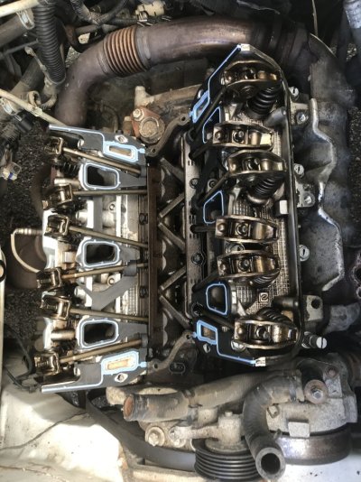

Working on this now. I got a used 3.4 last motor yr for $275 and it ran warm. So I had to do heads. Like I’m dong now on new rig. People seem to like the 07-09 3.4 equinoxes. I really prefer to not work on a 3.6. Due to ohc setup.
