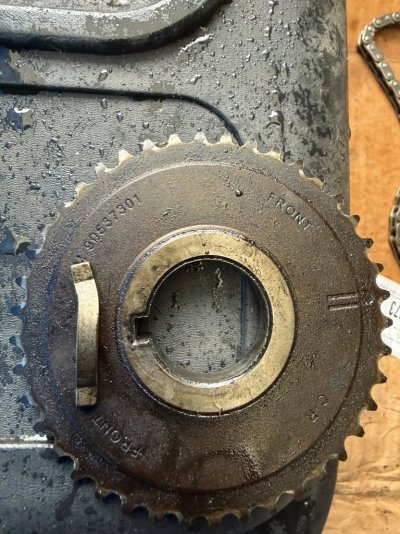

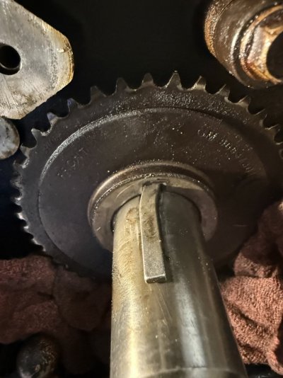

Hello all,
I recently replaced a VVT Solenoid for the intake side on my dad’s Equinox. Once the job was done I listened to the motor and heard the timing chain slapping the motor. Had him take it to a dealer to get quotes 3300 to do a timing chain. I bought the ALLDATA manual for the truck and have been working on the project. I got a mix of GM and Melling parts for the job. I have the balance chain, sprocket and tensioner part of the job done and going to get the timing parts of the cams done today and resealed up. I am changing the Actuators also while I’m in there. I did get the water pump too but I don’t think I really want to pull the manifold to get the water pump replaced…. Interesting find I had on the job… crank key was bent where the sprocket lines up. I’m not sure how this happened but it was like that when I opened the timing cover. Pics attached.IMG_0127.jpegIMG_0128.jpeg
