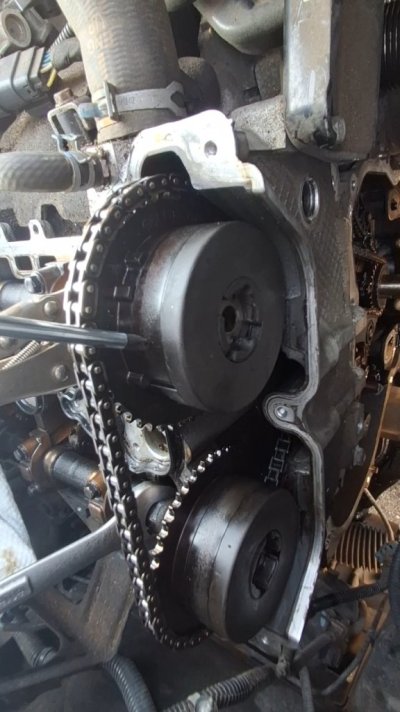

Phasers dropped from 2 to 1 bottom at 11
jaimlyn
Aug 5, 2026
WA
I have a 2011 Chevy Equinox 2.4 I had a guide break and I'm replacing the timing chain and the phasers so far I have taken out the tensioner Bolt the phaser bolts and the crankshaft bolt that's all I've done I was at 10:00 and 2 on the phasers and now I'm at 10 and 1 and the bottom is only at 11:00 instead of 12 I don't know what to do at this point because I don't want to ruin the engine by turning it over my question is can I put the bolts back in and restart to manually by hand turn that motor until it's at 10:00 and 2 again or until the bottom is at 12:00 I have not removed anything except for those bolts I've not removed anything else nothing's changed but it did move from 2:00 to 1:00 on the phaser and the bottom sprocket the timing the key way is not at 12:00 like it's supposed to be it's at 11:001401.jpg
