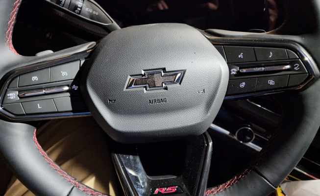

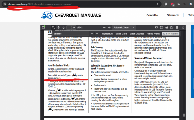

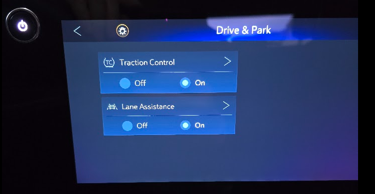

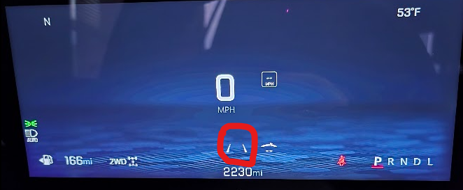

Update in case someone else in my shoes runs across this thread. I found where to turn on LKA, and it is not where the manual says. Also, once on, I did not believe it was working right. All of my impressions are from my 2016 Honda Civic. I had to take the car into the dealership yesterday for a heater issue that turned out to be a bad BCM. They test-drove the car and said the LKA was functioning correctly. In both cars when you take your hand off the wheel they track the lane more or less. I am NOT talking about self-driving. The Honda will track the center well, while the Equinox finds the lane by wandering from left to right. It also always goes to the left. After reading the manual more closely, I am guessing the dealership is right and the GM 2025 LKA is not as good as a 2016 Honda.
What the manual says ...
My confusion was caused by the manual being wrong.
It says the LKA is on the steering wheel, but it is not.
I found it in the settings.
Settings->See More Controls->Drive & Park
So now I finally had it on. :)
