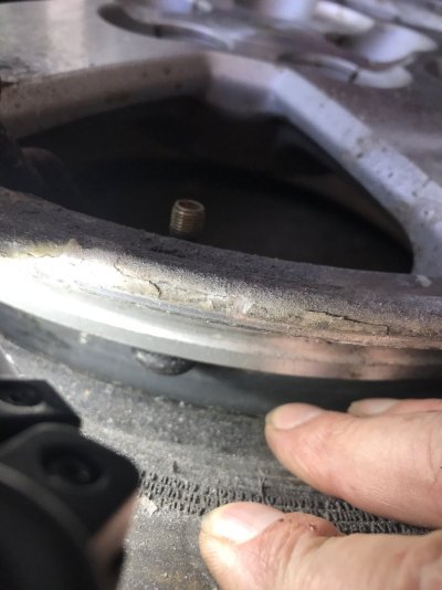

Got another equinox to fix. I can’t access tire pressure learn using dash buttons. It says press “check” to proceed. I think it is the keyless entry remote/receiver issue again. I had to replace receiver behind side pass panel to make it work last yr? Or was it 2 yrs ago? On another equinox. I think I got no replies at forum for issue. Seems odd I’d have 2 cars with same issue.
The receiver works for key fob AND tire pressure sensors.
317
55
I got a different receiver and when I turn on car DIC says wheel sensor programming is in progress. Seems I have 1 bad sensor as system will not finalize until it sees 4 sensors
317
55
Well, there ya go. 1 wheel has no tpms sensor.
