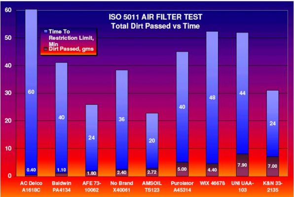

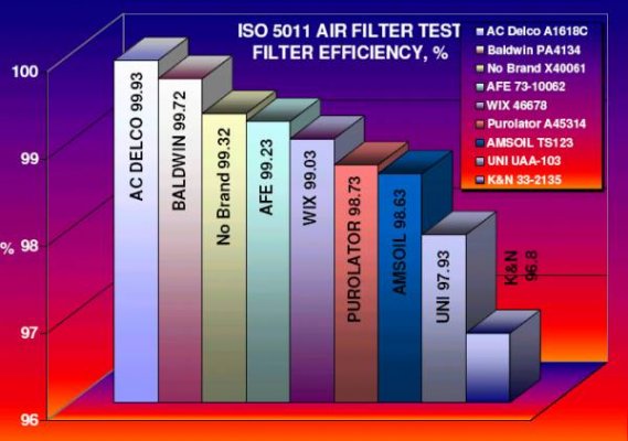

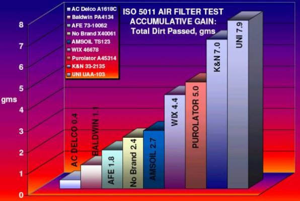

Every test ever done independently shows the K&N allowing more dirt into the engine. Even K&N's website says 95-98% efficiency at stopping dirt. I'd rather have an OEM filter stopping 99+% dirt than a bit more power at high RPMs.

I am no longer using K&N air filters after reading the results of comparison tests. K&N did poorley in filtering fine dust compared to stock paper filters,. I use only Wix or ACDDelco now. K&N do flow slighly more air, but at a sacrifice in filtering ability.

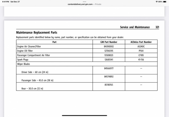

I have a 2024 Nox. My manual does not give a milage or time interval for replacing the air filter. The display says Air Filter Life is 70%. Do I trust the display?
Does anyone know the efficiency of the OEM air filter? The local dealer wants $60 for the air filter. I guess GM is real proud of them. I want to try and find an equvalent after market filter.

The OEM ACDelco air filter for your vehicle is $38.98 via Amazon.com and includes free delivery. Don’t buy the filter at your dealer. I have NO affiliation with Amazon.
