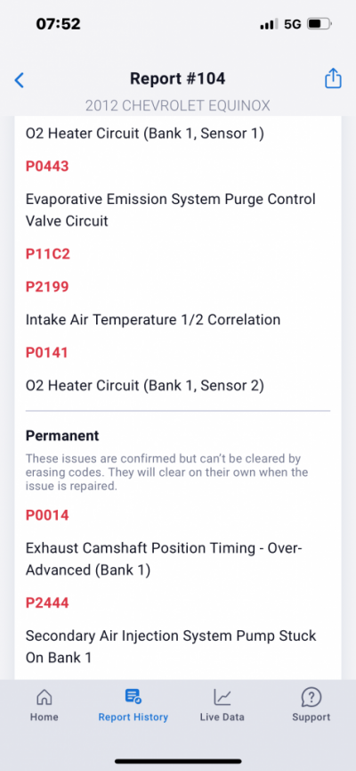

So i have new issues. It’s now throwing the following codes:
P0011, p0014, p0191, p0300, p2444 and p0442. There is a rough idle.

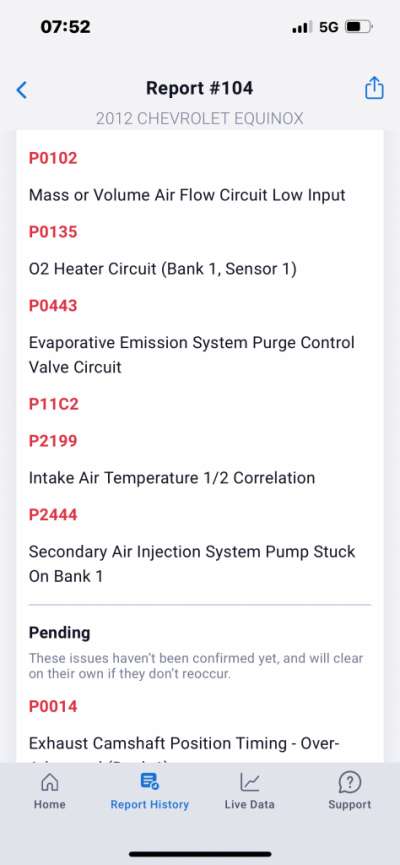

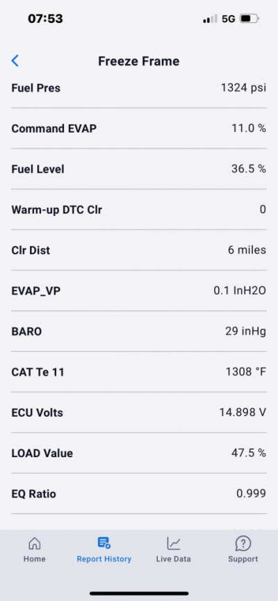

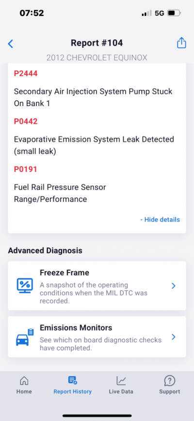

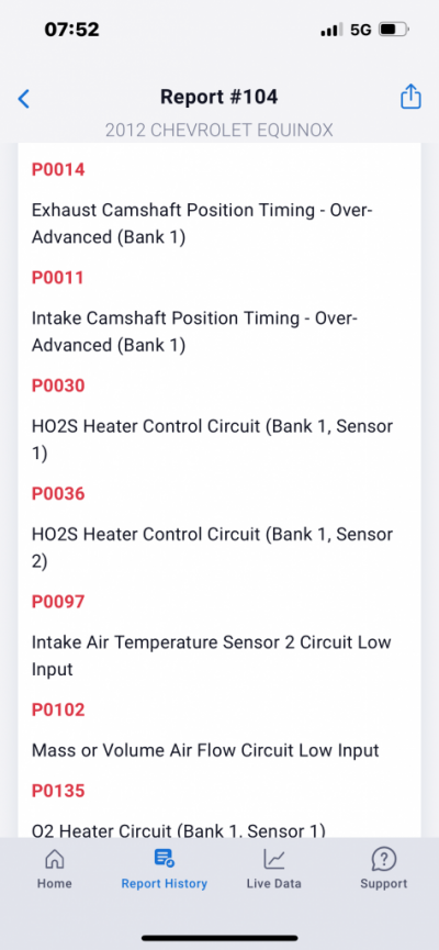

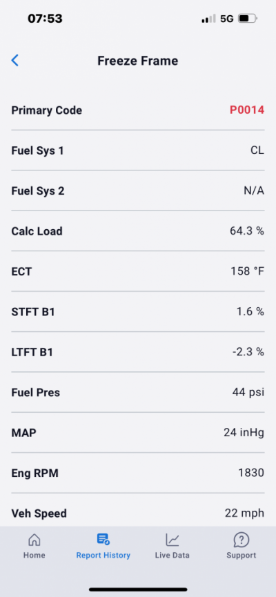

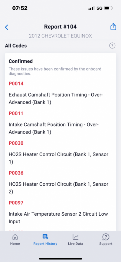

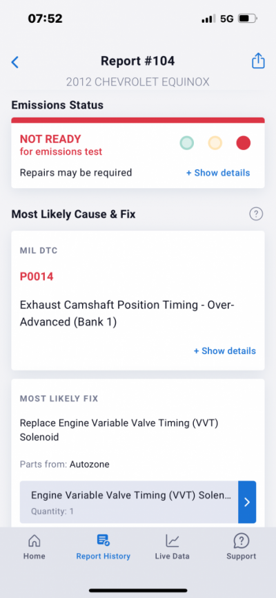

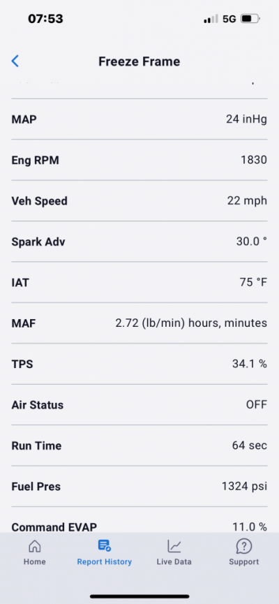

So I am hoping to get it repaired today. My mechanic friend and I ran my new obd this morning and I got these:
I can’t afford a big fix so hopefully it is just a matter of replacing the VVT solenoids like the obd recommended. I already have the parts, just need the tools.
