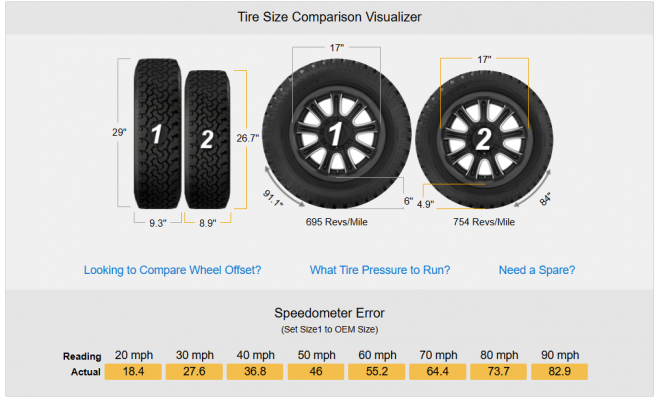

Nope... My factory Equinox Activ comes with 235/65R17 (the size on the right) vs your tire size. Well you could, but...
