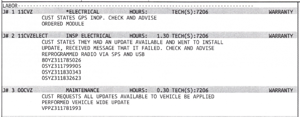

I have a 2025 Equinox RS AWD, built 3/2025. Since purchase there has been several over-the-air updates. The last one locked-up the system and failed to update, causing the radio to remain on, even with the car turned off and doors locked (after the 15 minute install period). The mileage was 4,5xx.
I took the car to the dealer and was told they were having new Equinox models returned with the same symptoms.
The dealer was able to download the failed update, and also downloaded six additional software updates (which changed some features of the computer menus or sub-menus). The service advisor was unable to tell me what the six updates were for.
You may be forced to return to the dealer for diagnosis and repair.
GM has done a MISERABLE job of software development and integration on the 2025 - 2026 Equinox models.
