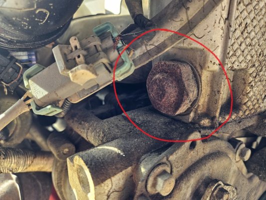

Timing chain wise I would never assume. Take a look at the timing chain tensioner and see if it looks newer. It shouldn't look like this if it has been replaced:
