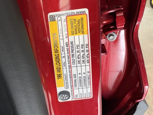

25 RS with 19” Continentals also spec’d at 41
My wife ordered and bought a new 2025 Equinox RS AWD with the Continental CrossContact RX 235/55 R 19 tires (20” was optional but we did not order those).
The tire placard specifies 35 psi for the road tires (60 psi for the spare).
Are you sure of the 41 psi specification for your 19-inch tires?
