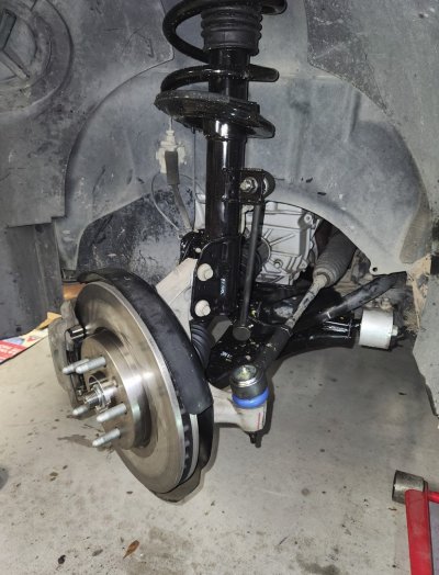

The car has 130+k miles on it and I've been driving for over 2+ years now with bad CV axles clicking away. I figured no hurry since they're pretty tough. Also the front brakes rotors are probably warped because I can feel it pulsing when brakes are applied. Since I now have brand new tires I figure it's time to get to work. Also the struts and shocks are long overdue.
So I pulled the $1200 trigger at RockAuto and will get to work shortly.
This is the parts collection so for for one side.
Monroe premium shocks/struts, SKF hub and bearings, GM lower arm with ball joints, Raybestos brake rotors and pads,1ap2.jpg
Rear shocks installed and I already notice a difference.

Front end completed on both sides. Each side took about four hours work spread out over six hours with breaks and other stuff getting in the way. Smooth ride now with no more rattles or clickity-clacks when turning. Now off to the alignment shop and change some of the fluids.
