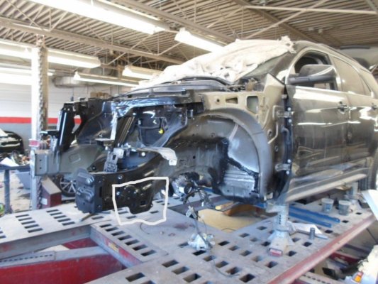

Hey all I have a 2007 Equinox. The frame rails where the cradle bolts too are rusting away on both driver and passenger sides. Does anyone know of any where that parts out rust free Equinoxes? Or are you parting any out. I have attached a picture of what I am looking for. Thanks!!!

Is that your suv? Or a found pic? I hope it ain’t sitting on frame rack waiting for parts. It’s fairly straight forward to cut out rust there and piece in flat stock to make a mounting location for the subframe bushing. It’s structural. Dosent have to be pretty.
Watch Yorkshire car repair on YouTube. They have good clear videos on frame repair on wimpy English cars.

No it isn't mine. It is just a picture I was using for reference

Even in the rust belt it is common to see cars with fairly clean underbodies. Fairly being subjective. You can find a subframe thru any junkyard. But you need the unibody portion that is part of “frame”. And cut it out. And find a shop to weld it in. Touchy
