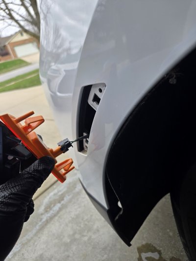

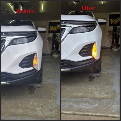

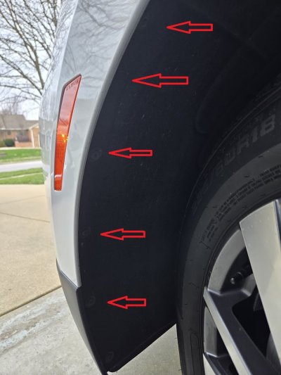

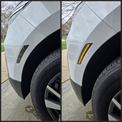

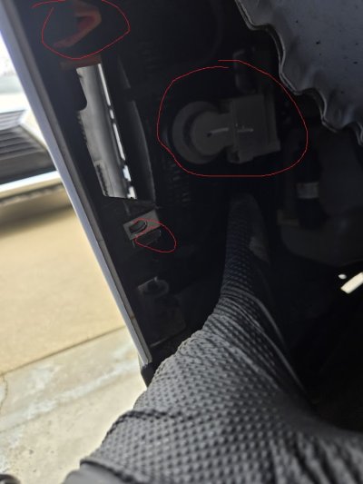

<blockquote data-quote="exploreco" data-source="post: 31195" data-attributes="member: 12203"><p>Continuing my upgrades of the remaining halogen lights on the 22 LT. Upgraded the front turn lights with Lasfit 7443 T3 Series Amber bulbs I pulled them from the car I traded in so already had them laying around Quite the difference. Also threw in the smoked side markers for fun while I was in there. Including steps for anyone that doesn't know how. These were way easier than my last car.</p><p></p><p>Turn wheel in for the side you are working on. Remove screws from edge of wheel well liner, T15</p><p>[ATTACH]3575[/ATTACH]</p><p>Peel the liner back. The turn signal bulb is the gray plug. Twist out and replace the bulb. The side markers just release by pinching the tab. Unplug and replace with the new light.</p><p>[ATTACH]3576[/ATTACH] [ATTACH]3572[/ATTACH]</p><p></p><p>[ATTACH]3577[/ATTACH]</p><p></p><p>[ATTACH]3579[/ATTACH]</p></blockquote><p></p>
