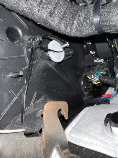

<blockquote data-quote="Tico007" data-source="post: 31682" data-attributes="member: 7026"><p>My 2013 had a problem switching between heat and AC. I researched the problem and it turns out a lot of people are having a problem with the control panel knob sending a bad signal to the actuator causing calibration problems. The actuator not knowing how far to turn the blend door so it bangs eventually breaking the blend door. Which is a lot worse. The fix is replace the control panel for a high cost if you can even find one that matched. I’m not doing that so.. I removed the actuator. Took the actuator apart and use the gear as a key. Couple of screws a tie wrap. The blend door is open for the season. Then when summer comes, cut the tie wrap and you get AC . It’s not hard. [ATTACH=full]3683[/ATTACH]</p></blockquote><p></p>
[QUOTE="Tico007, post: 31682, member: 7026"] My 2013 had a problem switching between heat and AC. I researched the problem and it turns out a lot of people are having a problem with the control panel knob sending a bad signal to the actuator causing calibration problems. The actuator not knowing how far to turn the blend door so it bangs eventually breaking the blend door. Which is a lot worse. The fix is replace the control panel for a high cost if you can even find one that matched. I’m not doing that so.. I removed the actuator. Took the actuator apart and use the gear as a key. Couple of screws a tie wrap. The blend door is open for the season. Then when summer comes, cut the tie wrap and you get AC . It’s not hard. [ATTACH type="full"]3683[/ATTACH] [/QUOTE]
