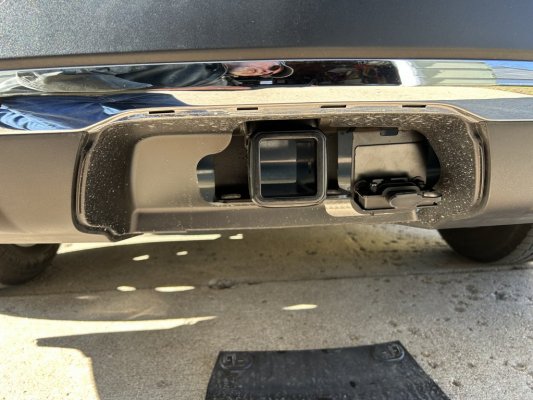

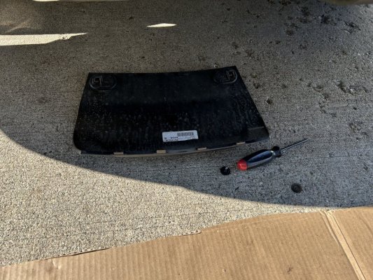

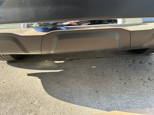

After a couple months waiting for a GM hitch, I finally got it installed Tuesday. When my car was ready, I expected the hitch to be showing. It wasn't. I like it.

Did you also have to purchase any other fitment parts like a new bezel or closeout, or did they come with it? Or were the stock parts sufficient? I see the cut out for the hitch on the rear bumper is the same as my wife's Equinox.
It looks simple for me to install by the look of the part; however, I did not get under the car to see what obstructions might be in the way, etc.

With our later model Equinox’s rear fascia there is no need for a separate bezel or cover. Everything’s already there. I didn’t want to take a chance on damaging my fascia so I let the dealer do the install.

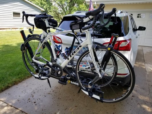

Here's the Saris rack we have.

I ordered the hitch online from GM and had it shipped to the dealer for installation. The hitch replaces the bumper support bar.
