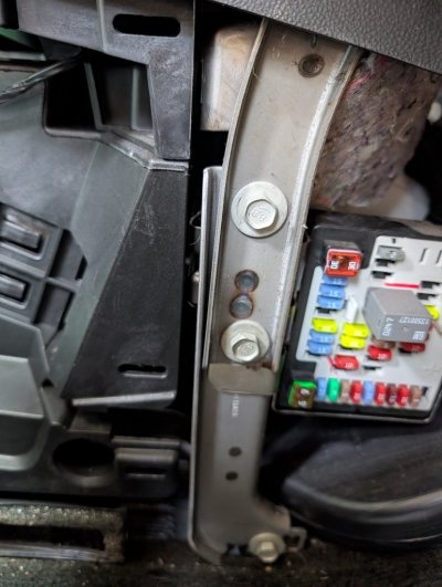

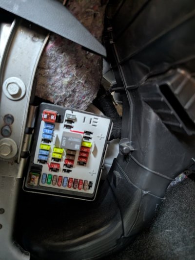

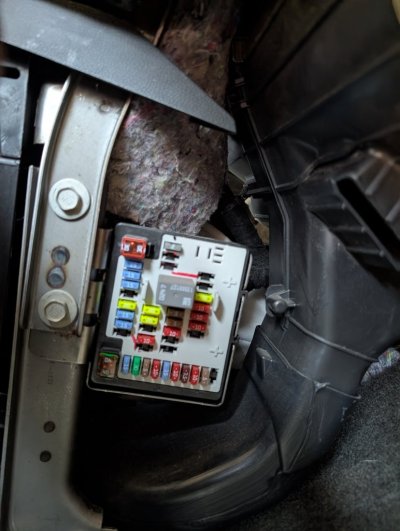

This week's issue. The AC is leaking onto the passenger floor. Apparently it is not good to say. Oh well, at least it's not on the driver side floor to your wife who has to sit in passenger seat.

She can fill her water bottle from over there! Kidding of course..
As @RIT333 mentioned, it sounds like the condensate drain tube has something going on.

i have seen 2 diffrent videos on how to clean the drain . One was inside the car and the 2nd was from the engine bay. both sucked at camera work.

If you can find the hose stub underneath the car, I'd just use a shopvac to suck it out. If the hose is buried in a frame rail, etc, you'll have to try to find it inside, usually behind the pass side center console, running through the firewall.
