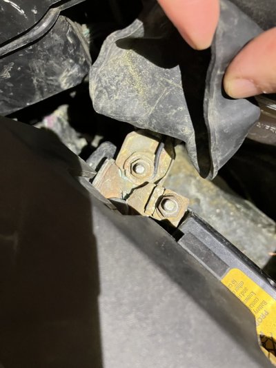

I previously had some corrosion issues on the battery connections when I had replaced the battery several months prior. I cleaned them up back then, but in trying to sort out this issue I thought it might've been the battery current sensor. When I took apart the battery connections and box to try and get to that I looked closer at the single small cable coming off the negative battery cable. Found more corrosion deeper in there. Ended up cleaning up that as best I could and that seems to have resolved the issue for me. I can't say that was the root cause for sure, but I haven't had that issue since.

Thank you so much for replying. It got me thinking that there must be something wrong with the cable or battery current sensor since both the bigger and smaller cables have to go through that sensor. Went to look at at the negative terminal again and discovered my small/ground wire was broken! Not sure how the garage didn't notice this. I just snipped below where the connector corroded away, stripped the wire, and wrapped it around the nut/bolt where the connector was fastened. So far so good and no Battery Saver Active alert after a half hour of driving. Sprayed some battery terminal protector all over the terminals and hoping this'll last a while.

Awesome. That's great confirmation for me to know that single wire was my issue then too. Never seen a battery connection designed like this with another separate cable off the negative. Wish it was better documented so I could understand its function. Glad you didn't waste money on replacing the alternator like I did.
